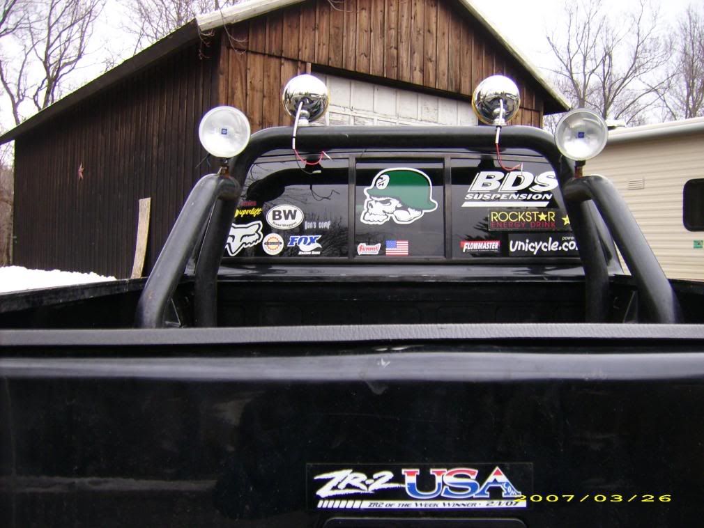

Posted 12 February 2012 - 09:41 PM
35's offset alot with a 5" bds and SL 2" and i wasnt afraid to cut when it came to my fenders. rubbed only offroad in the front when steering and thrashing. on the street it was fine. after the 2" BL i had handfulls of clearance.
and one last pic for the site.
