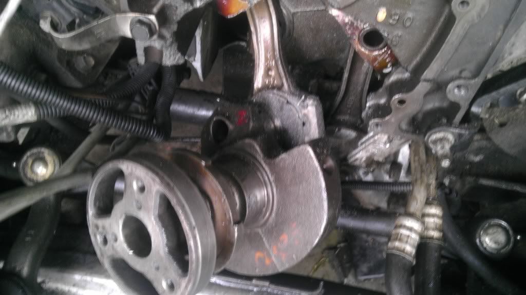

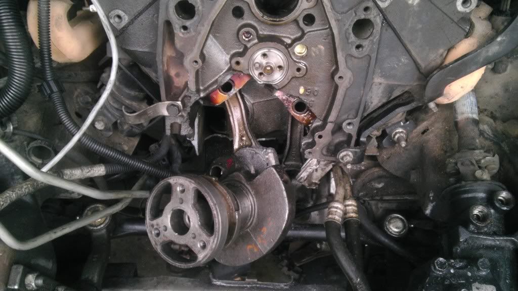

long story short Im in the process of doing a motor swap, 4.3 to 4.3 story later, at the current moment I have the oil pan detached from the block and the block lifted a good 3 - 5 inches, however, I cant find any diagrams to access the rest of the bolts from the block to the tranny!! can somebody PLEEAAASSEEE point me in the right direction??

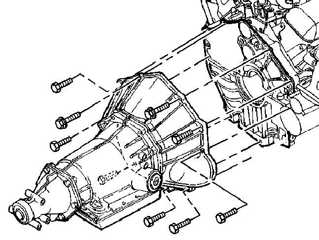

These here bolts?

If it is an auto trans you will also have to go through the starter hole and unbolt the converter from the flywheel. You will have to manually turn the engine to access all the bolts.

Why do you have the pan off, and why do you have the motor lifted?
He took the pan off without even getting under the truck -
#6 N2O_ZR2
  • 22,156 posts
Posted 21 March 2012 - 11:01 AM
Holy fuck, how did he manage that?

QUOTE (N2O_ZR2 @ Mar 21 2012, 11:01 AM) <{POST_SNAPBACK}>
It's had a knock for quite a while, it wasn't real high on his priority list, apparently.
Claims he was driving down the highway, 65MPH when everything "seized up".
He's officially more of an engine-killer than Josh. This is the second motor in 3 years or so that he's thrown a rod in.

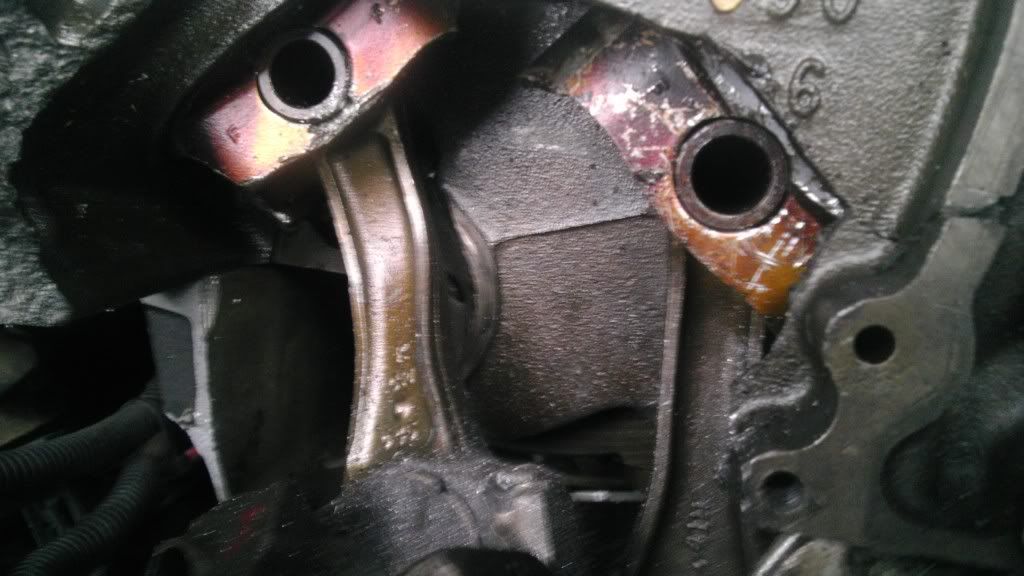

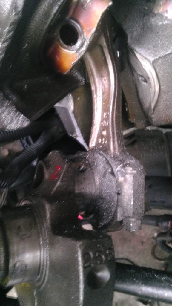

QUOTE (jwwaldschmidt @ Mar 21 2012, 12:16 PM) <{POST_SNAPBACK}>
That's more than just a rod knock, I bet that pan was dry as a bone.
Look at the heat marks on the pistons. That is absurd.

Aside from the obvious signs of neglect..... a little help to the OP. Remove the trans x-member, get the engine block as low as possible to original height, droop the trans, and use a 36" extension and a 15mm swivel socket to remove the trans to block bolts. And as stated above, remove the starter and unbolt the torque converter from the flex plate (do this before trying to remove trans to block bolts).
