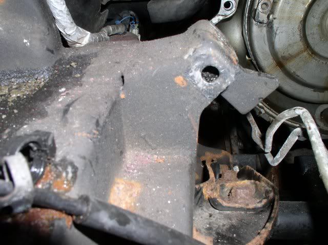

the zr2 frame is different that a normal 4x4 s-series. normal s-series have a 2 part motor mount system. the rubber mount that bolts to the block and a bolt on frame pad that bolts to the frame. In a zr2 application there is the rubber mount that bolts to the block and then the frame pad is an integral part of the frame. meaning it cannot be removed. meaning those mounts will NOT work on a zr2.
Edited by 6speedblazer, 12 July 2011 - 04:42 PM.

Ok, to each his own, but my grinder disagrees.

lol, agreed. But we got a pair of these free when Baja was in "test phase" and got a store credit in exchange for time/labor/whatever. We were just jazzed to be working with someone like them. Install was easier than expected. The motor was out already and the torch did most of the work.
Sorry guys, I wasn't trying to be an ass or make an issue of it. Just tryin to say that with a little work, you can do a lot more than you think, if thats what you really want to do. (Chris-not that you of all people would need to be told that)
