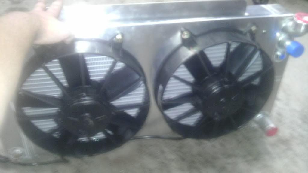

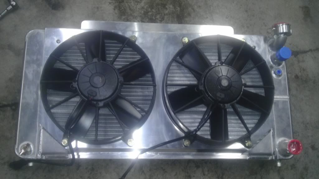

QUOTE (jwwaldschmidt @ Nov 24 2011, 02:43 AM) <{POST_SNAPBACK}>
On the radiator debate -
If you're willing to spend some dough, Current Performance sells a VERY nice all-aluminum V8 swap radiator. It's designed for an LSx swap, but I see no reason why it wouldn't work with a 350. Expensive, though.
[img]http://i273.photobuc...dt/IMAG0127.jpg[img]
[img]http://i273.photobuc...dt/IMAG0126.jpg[img]
[img]http://i273.photobuc...dt/IMAG0125.jpg[img]
they also sell one that has the propper hose locations for a SBC

Good to have the site back up. Very nice rad and fans but OUCH! $815.
